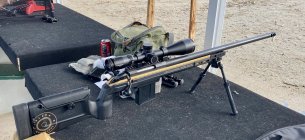

My 22CM was the easiest gun to tune and shoot at 1000K to 1400. I am shooting Alpha brass and 80 grain ELDM's. Tikka T3, action work and Benchmark Barrel installed by Georgia Precision.
