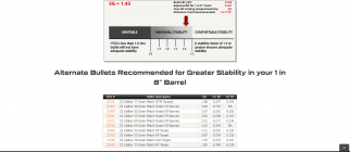

Here is how you can study the twist stability question yourself. It really is very simple to get an SG estimate and it doesn't cost anything to use.
https://bergerbullets.com/twist-rate-calculator/
Here are the input windows.
and here is the output
I used 2750 for muzzle velocity, then put in your 1:8, then moved your average elevation in Illinois to 600 ft.
Going up in speed adds a little margin, for example you get 1.46 at 2950, going up in altitude adds more.
The code estimates an SG = 1.43 at 2750 which is very close to their recommended 1:5, so you won't have a problem.
On the other hand, the most common twist for this kind of thing is a 1:7 in order to meet the BC expectations, but some folks run these at 1:8 with no problem unless they go to sea level. YMMV

I've had so-so results using that bullet in a 223 with 8 twist barrel. Specifically a Tikka Varmint, 24" barrel.
Groups just haven't been as tight as I'd expect. The "marginal stability" as shown in the Berger calculator is what I've come to think might be the problem. Of course, YMMV.
