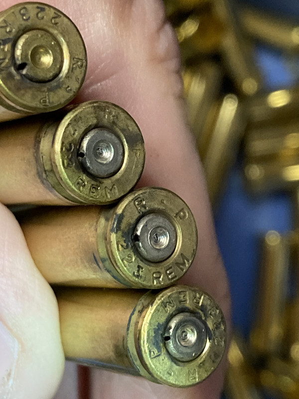

6X45, happened on second firing but now some cases are up to 4th firing, Remington commercial brass. 2 different loads, one 105 Bergers VLD with 21gr Benchmark, the other 68 Berger flat bottom with 25.5gr Benchmark.
Was having maybe 1 in 20 with Remington 7 1/2 primers, new load with Fed 205M and it dropped to maybe 1 in 50.
Not blowing out through firing pin hole, not around primer pocket, it's blowing a pin hole out in the radius of the primer cup (which obviously flame cuts the bolt face).
Ideas? No heavy bolt lift, primers still show radius, not flattened, firing pin dimple not cratering back out, no flow around firing pin bore, no ejector dimple on the brass, not too much head space, prime off the press and the hand pressure feels normal. 700 action, PTG bolt, factory pin, new Wolf spring...
I'm not terribly worried but it is annoying that my bolt face looks like it has acne. :)

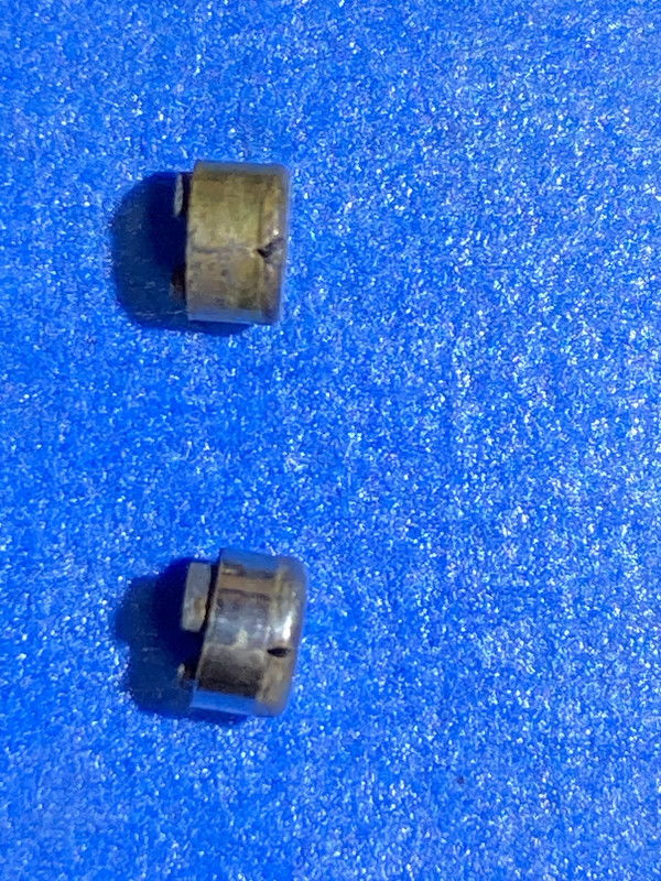

It is a primer problem, not a load/gun problem. I've encountered it:
- with the Rem 9 1/2 primers from back in the 70's
- with older and newer Rem 7 1/2 primers
- with new WLR primers (Winchester bought back 10K from me and paid to fix my bolt face)
On the Rem 7 1/2 primers, it seemed to be much worse with primer pockets that were somewhat loose. Once I started culling those cases, the problem went away.

WOW. That definitely looks EXACTLY like what I am having.... Interesting....

Looking at your pictures, I notice the brass case head has a overly generous radius at the top of the primer pocket (common with R-P). This leaves more of the primer unsupported, not too different than I found when the primer pockets were loose. If you pick some brass other than R-P that doesn't leave as much of the primer unsupported, your problem may go away. Also looks like you have a good bit of clearance between your firing pin and the opening in the bolt face. It is causing the primer to crater, but not due to excessive pressure.
Didn't think of that.... I may buy some different brass and try them. I didn't consider the RP brass would be radiused at the pocket. Kinda Glock unsupported chamber bulge thing. I like that.
