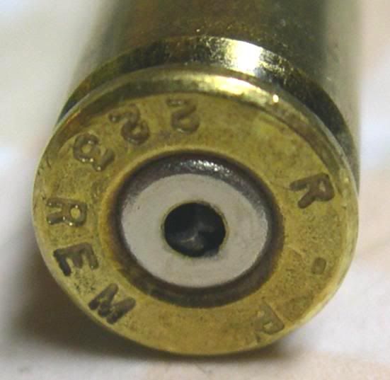

Below example of excessive head clearance on a over gasses AR15 and bumping the shoulder back too far.
Below pressure forced the anvil through the hole in the primer.

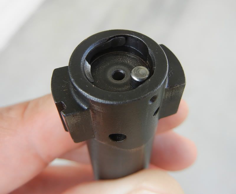

I have a Remington 700 30-06 that has a beveled firing pin hole in the bolt face like below. But I do not get brass flow around the firing pin and firing pin hole.

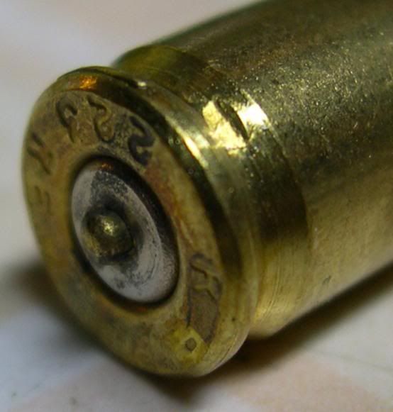

Here's a pic of the 6.5X47s fired in the FN with a very mild load before rechambering to 260. (These are Remington 7 1/2 BRs.)
