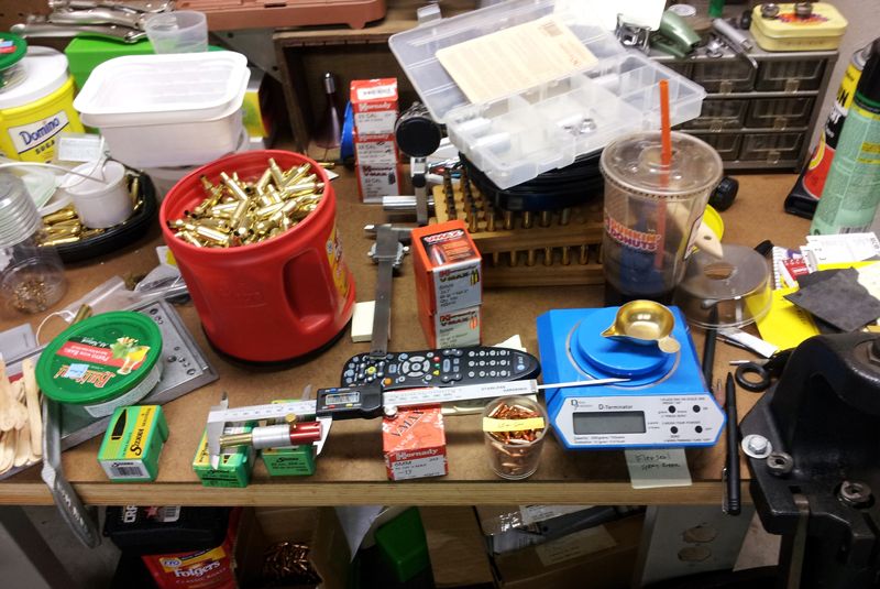

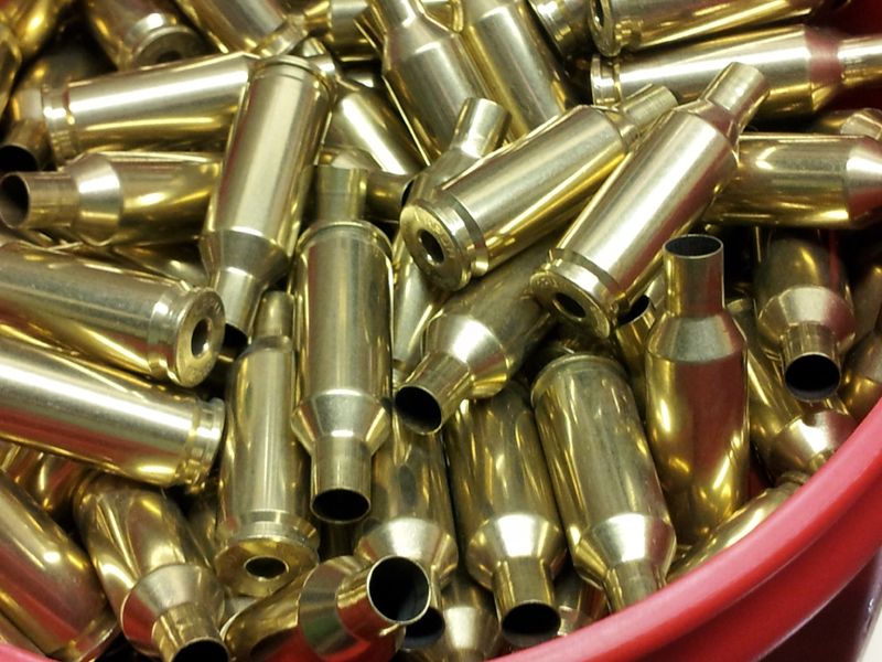

I thought that was an interesting question, so I went and measured a bunch of 6mmBR tight necks from my HV rifle.
I took a bunch of twice fired cases from a bucket that is waiting to be loaded. They have 0.0085" neck walls (I removed the keyboard just for you ;) ).
As you can see, they are neck sized.
I zero'ed on the first case I picked up and measured 26 cases. The total spread from longest to shortest was +0.0005" to -0.001", for a total of 0.0015".
Actually, I was surprised that the variance was that small - none of my comp and BR bullet seaters (and bullets) will seat even close to that tolerance, so using a short sleeve is a non-issue in making accuracy loads.
(I'll put the keyboard back now ;) ;) ;) )
