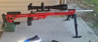

Back at the range today. 2125 on the ARA card. Pretty consistent tailwind 3 - 5 mph. So it became a good exercise in estimating how much the tailwind would raise the impact. 3 shots pretty much ruined my score. :)
Shooter error I'd guess. Hard to imagine this Vudoo S22 being the cause of my problem.
A friend of mine has a Vudoo and is having a hard time getting it to group at 100 yds. He is shooting Lapua Center X and Eley Tenex.
My V-22 had no luck with anything Eley. Got some Center - X to test.
Midas + shoots well as well as SK Rifle Match.
