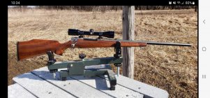

I have been tossing around a Hart #3 8 twist 6.5 barrel in my shop for over a year. Didn't have a use for it when I got it just figured be good to have around.
While I have others I could use, I don't think I currently have a 6.5mm chambering. Was tossing around 6.5 creed, but I was going through my stuff the other day and realized I have a handful of winchester brass and some 6.5 sweede dies. I also have a 6.5 sweede reamer. A bunch of misc 6.5 bullets. I have a creed reamer too but no brass of dies.
Going through donors, I have a 1917 enfield I did up a few years ago with a nice walnut stock. Threw a recycled and rechambered 22-250 barrel on it cause I had the 22 cal barrel sitting around. I don't really shoot it much, but it's a nice setup and I think the sweede would be a perfect fit for this rifle/stock combo vs the 22-250.
Was thinking the SS barrel with a matte blast and the blued action/walnut stock would be a nice "modern classic" style rifle in a classic capable cartridge. I just don't see doing a creed on this setup vs the sweede. I've had 6.5-06's, 6.5-280's, and wanting another rifle I could have my kids shoot when they get a little older. Will eventually go to one of my 4 kids.
Will probably pick up some lapua brass and load up some hammers to make a nice sporting rifle? Below is the rifle I plan to rebarrel.
All in favor say aye!
