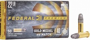

Why does USA not have a target 22LR ammo that will compete ?
The original GMM with the dimpled head was made by Federal. It was discontinued by the bean counters to be able to make blaster ammo. It is a shame that no one makes Olympic quality ammo in this country.
it was discontinued for the simple reason that not nearly enough buyers showed up to continue production, all the tooling was sold off.
