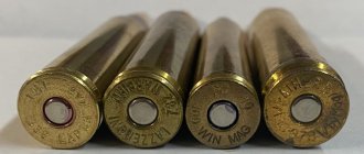

Yeah, I don't have one though, now their bullets, much different story. I should say that grabbing that IMI factory .338 round for a picture, of what is Lapaua's flagship cartridge, was not on purpose (but they do shoot!). My brass is blue and 338-LPA is still one of my license plates, but do make us brass again, please.
