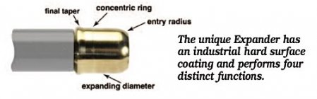

When I load jacketed bullets, I don’t push the expander/bell mandrel very deep in the case. Just an 1/8” or so. Then, when loading, I push the bullet in the case, letting it expand the brass for a tight fit. This doesn’t work for plated bullets, as the tight fit will shave the thin copper coating off the lead.
RCBS has an "M" type expander, with their die set. No shaving of lead bullets while seating.

As mentioned above you might want to play with the amount of flaring to the case mouth. If using a progressive press then adjust the Powder Funnel/Flaring Die or start using a dedicated expander die, such as:
> RCBS M Expander Die or
> Lyman Universal Expander Die with a NOE Plug that matches your desired expansion
Finish this off with a light crimp and you are good to go. Now the last important step is drop each of your loaded 9mm cartridges into a Case Gage (essential QC tool) to quickly check all of your dimensions. If it drops in and falls out then you are good to go. Wilson makes a nice steel case gage.
