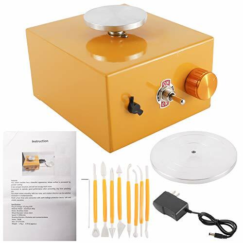

Would you mind sharing the parts needed for that pottery tuning wheel and case holder you used to build your annealer? I thought pics of it were in this thread, but I guess you showed it in another thread.
Here is the video:
1) mini potters wheel ( went up in price in 6 mos!) I'd offer $20 on one without the sticker.
2) case holders ( i cut down to make them shorter). https://www.littlecrowgunworks.com/store1/308-Win-Brass-Annealing-Mandrel-p128369320
3) tight wrap ss spring ( i got one off a coleman cooler). Have extra if you cant find.
4) 2 cent drywall anchor plug that fits inside spring and on the shaft for the pottery wheel.
5) pair of thin spring loaded needle nose pliers.
6) pencil tip burner nozzle.
Here is the video:
4) 2 cent drywall screw plug that fits inside spring and on the shaft for the pottery wheel.
Thank You!
