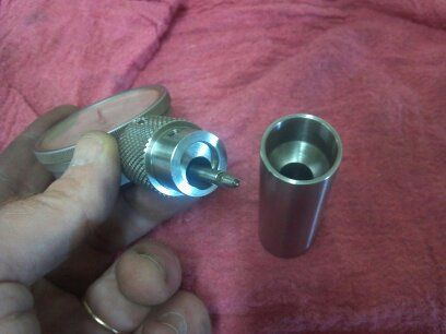

You can use the Wilson gauge on your granite block stand with dial indicator. You can always return to zero when changing from another cartridge by zeroing the top of the gauge and it will repeat the same readings It's foolproof and the Wilson gauge is still very well made. You disregard trying to sight or using a straight edge or calipers on the gauge and if the case is below or above the top of the gauge surface it don't make any difference with the dial indicator it still measures it.
The Wilson Headspace gauge for the belted magnums measures headspace on the shoulder and the shoulder portion of the gauge is an insert which is adjustable with a lock screw which is very handy, since you can have the head of the case always above the gauge surface and measure it with your calipers or dial indicator stand. Very neat tool.

With the Wilson gauges and the comparator stand and a wide choice of dial indicators it would be pretty hard to be more accurate and also repeat it, but I'm not looking for an argument and appreciate your writing in so the thread starter can get a good picture.
The Wilson gauge will indicate that the round is within SAAMI specs. It will not indicate a precision headspace fit to your (emphasis on "your") chamber.

Yes the Wilson will indicate your personal chamber headspace for your case. It's a chamber itself. Once you establish the correct push back of your shoulder that you want and then set your die to push shoulder to that point you can check and maintain that with this gauge and a comparator. Don't forget you have to maintain paralalism with the Stoney Point on the calipers but I understand you can have a set-up case to check that with (and they are other methods) the Stoney and the Stoney is ok, the Wilson is foolproof solid steel and if it sits on a machined metal or granite base with a dial indicator (many to choose from w/ different accuracies) that is locked parallel on it's holder (and stays that way) it is a precise way of measuring and most important repeatable. The person that started this thread wanted to know the differences and I told him a time and proven method because he indicated the Wilson vs the Hornady (Stoney Point). I also have nothing against the Hornady and others. I have partial chambers made up on old barrel stock that are just the berries cut with the same reamer that cut the chamber w/ the neck bored out slightly. There are many other ways of doing this measurement also but I'm running out of room.

The Larry Willis gauge is a very nice gauge and I don't think that the price is too high but the thread starter didn't mention it. Larry Willis is going directly to the shoulder for the measurement and the case head is sitting on a machined surface, measurements will be very precise. The Wilson gauge sits on a machined surface w/ the shoulder pushed down against the shoulder recess and the indicator is touching the case head which is also a very precise measurement. The thread starter has all these to choose from, he can make up his own mind and costs surely means something.
