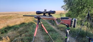

Nice! I like that .223 setup. Really makes me want to upgrade to a better tripod. This is my current setup. It works. Except for the optic, the whole thing is pretty easy on my wallet, and even the optic is pretty reasonable. Savage 12FV in .223 from Cabelas in an Boydes At-One thumbhole stock with an Athlon Ares ETR sitting on an older BOG POD.
