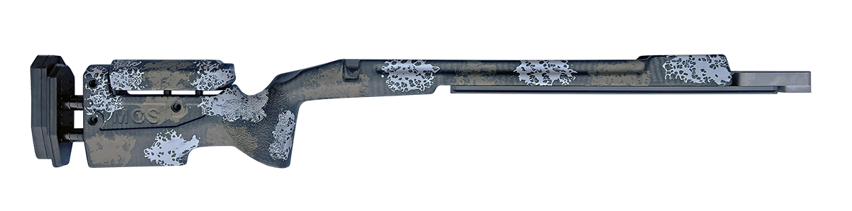

The Manners T5A is probably my favorite and most comfortable stocks of all time. The T2A-Gap is another nice stock that works great a varmint stock.Both of these can be shot from a bench and prone also. I also have several of the EH1A's that shoot well out past 1000. I am really liking the LRH also.
