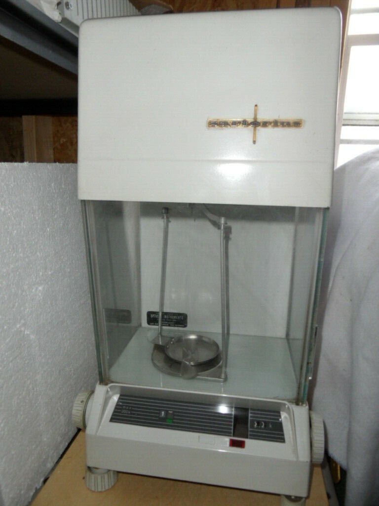

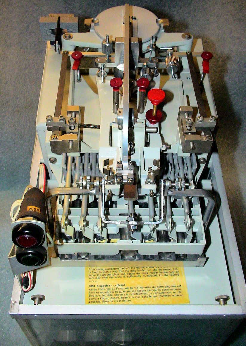

I had this Satorious beam scale for a while that I bought from a professor from the university many years ago, I wish I still had it just to show you a picture of it. It was an elaborate affair full of multiple beams and ruby pivots that once upon a time would have been the envy of every pharmacist in the land, as good as that was, it does not hold a candle to my Vibra HT 220.
This Satorious beam scale was affected by air currents, that's why it requires a glass enclosure.
I actually found a similar one on ebay, so here's some pics.
I do not know what accuracy they claimed these were capable of but its obviously more advanced than a typical beam scale.

I had this one Satorious beam scale for a while, I wish I still had it just to show you a picture of it. It was an elaborate affair full of multiple beams and ruby pivots that once upon a time would have been the envy of every pharmacist in the land, as good as that was, it does not hold a candle to my Vibra HT 220.
I found one on ebay.
No doubt this is a wonder and accurate scale. But, it look cumbersome to use. I see no way to dispense powder.
Holly Moley!!!
