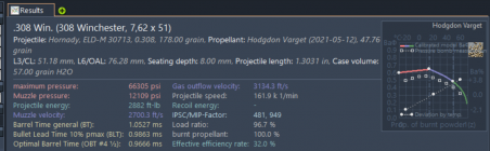

What chamber pressure do you calculate to launch a 178gr bullet at 2800 using varget in a 20" barrel?
With the right chamber and brass its actually not that bad, obviously this isn't 100% accurate but its a good indication that its not n pipe bomb
Something to remember though, when looking at load data the max speed/FPS is what you should keep an eye on not the max load.
Very informative. Is the max pressure to produce 2700 with this bullet 66305psi? What length barrel is used in this calculation?
