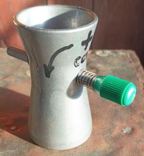

I have a RCBS trickler that I use with my balance scales. With much use, I have gotten very proficient with it.
I modified my RCBS trickler to add a coil spring to the trickler tube...if I need to add "a lot," I position the tube so its ingress hole is upward (painted a line on the tube to indicate this), then thrust the tube forward, toward the pan, and it adds much more, faster. Then when you get close, you can "rotate trickle" to the mark as normal.

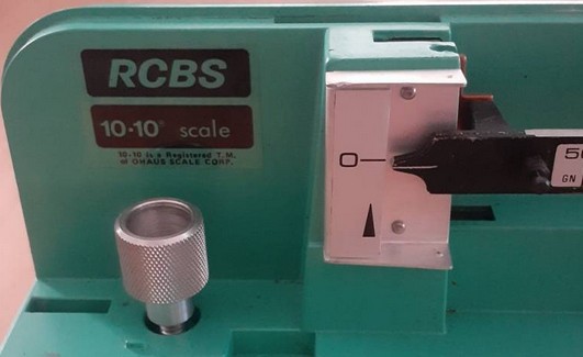

No parallax on my RCBS 10 · 10, since the moving "pointer line" and the stationary "center line" are in the same vertical plane, and when it indicates "on," the two engraved lines are in the same vertical plane, the same horizontal plane, and are probably less than 1/32" apart, left-to-right.
It reads the same whether you're standing up, sitting down or lying on the floor.
I'm fairly certain this gets me to within ± 0.05 or 0.1 grain, which is more than I need.
As for the rotating tenths wheel, it seems like a hassle until you consider that the sliding weight with notches is a fairly delicate arrangement, easy to bump accidentally and move unwittingly, whereas the threaded wheel is harder to move and also has a plastic screw to clamp it in place ... great for loading 100 cases with the same charge. I do that far more often than I change charge weights with every case (such as for a ladder test). YMMV
