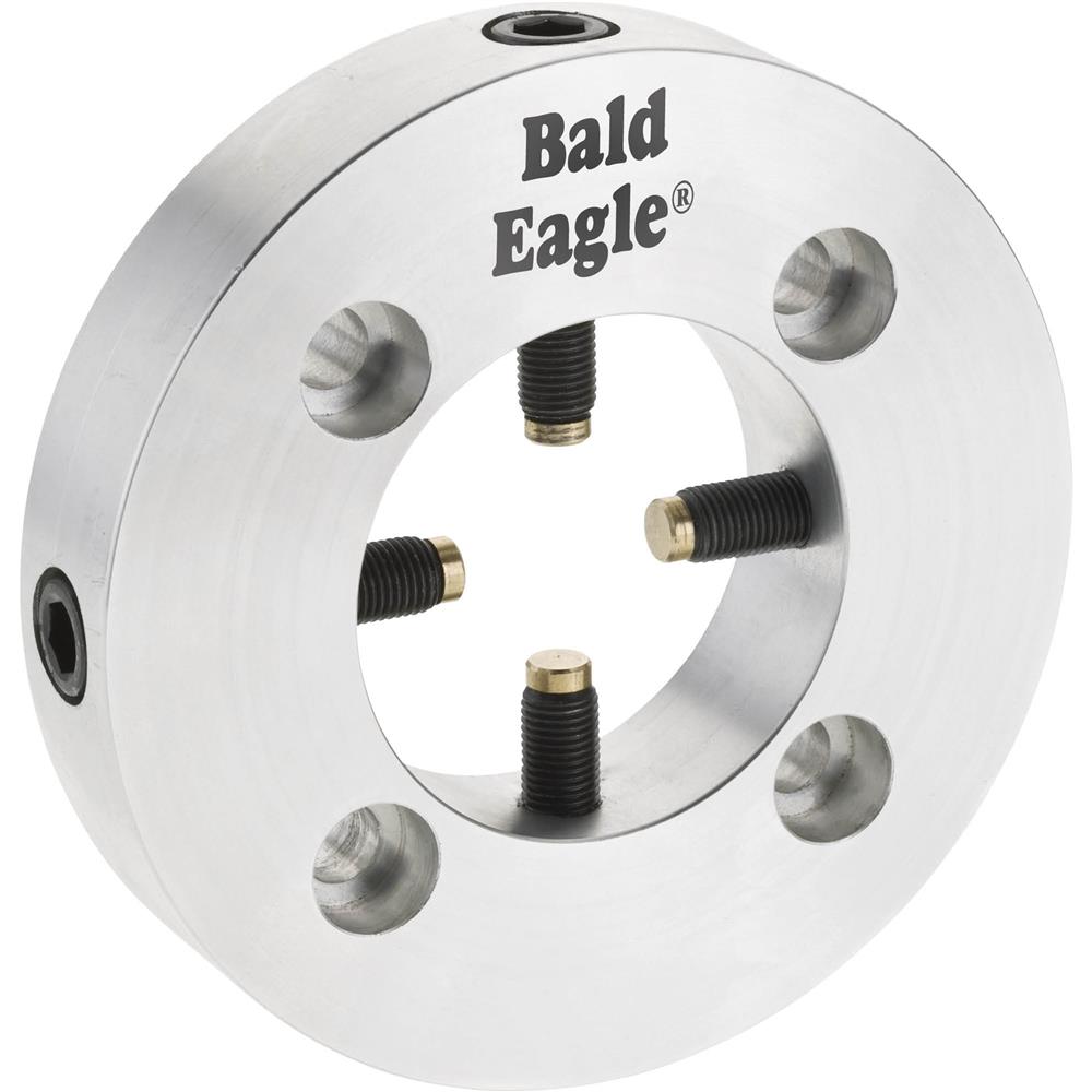

If your just needing a four jaw chuck for regular turning needs not chambering barrels Gator chucks aren’t than bad for the money. But a inboard spider is they way to go for barrel work.

For the money this spider is hard to pass up.
I used one and mounted to D1-4 backplate for my PM-1340GT. Once mounted, you can turn OD, bore ID and get it perfectly true. Tig welded a 5/16 bearing to end of 3/8-24 set screw. 5/8" OD x 1/4" thick aluminum pad with a recess for bearing, allows it to swivel. Works well and pretty cheap inboard spider.

"Assuming" you're chambering through the headstock, consider using an inboard spider if your budget allows. You certainly need a chuck, but a spider allows you to work closer to the headstock than you can with a chuck.
The closer you can work to the end of the spindle the better off you are.

Everything from a heavy gauge copper wire in the chuck jaws, to brass-tipped screws and other type "tips" in a spider.
