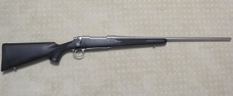

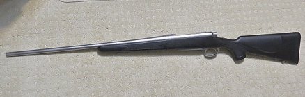

I'm looking for a precision rifle in police/sniper/sporter style. I will handload for accuracy. The goal is to see if I get lucky enough to find a 1/2" MOA factory Rem 700 right out of the box that won't need another $850 barrel with smithing. I will initially install an alum blocked H-S stock, Jewel trigger, and work up handloads. I'll add a DetachMag later if it's a keeper. I've been lucky before and got 1/2" 5-shot groups in a LVSF 221Fireball barreled action this way. I know it's a crap shoot, some factory 700's might do it & some will not. I own a like-new SS Rem700 in 270Win I bought on GB. I intended it as a donor rifle to be smithed into a 280Rem, but now do NOT wish to pursue expensive barrel & smithing.
I like the flat shooting 7mm caliber bullet and power of the 280Rem, but suspect the long powder column doesn't help to arrive @ 1/2" MOA. Would love to hear the contrary & be talked into it. LOL A standard weight barreled action like the one pictured below sure would be nice for a change. My current stable has too many 12lb -16lb varmint rifles.

On a factory Remington or for that matter any thing else it is the luck of the draw. A friend had a 6mm rem rifle and it was a sure enough tack driver. Ive never seen one that was very good. If you get one that has a decent barrel and the chamber job didn't mess it up it should shoot. but those are pretty big ifs on factory gun.
