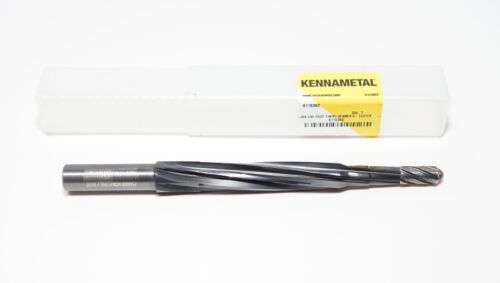

I was thinking some Kennametal Nasa thing.
Speaking of which, I saw a Kennemetal "Chamber Reamer" on ebay
it was pricey like $400
But never knew Kennametal was into making of all things ....chamber reamers?
Anybody else seen or used one of theirs?

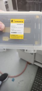

I seen some kennametal boring bars for a swiss lathe a few days ago, OMG, awesome yes but I'm sure pricey
The kennametal reamers are new. They were announced at shot show this year. Surprised to see them on ebay so soon.
I saw that too, The guy selling it didn't list whether or not it's carbide or HSS, At that price I wasn't going to waste his time asking, The pilots looked goofy too, No thanks.
Yeah that reamer was way too pricey for just a .308
