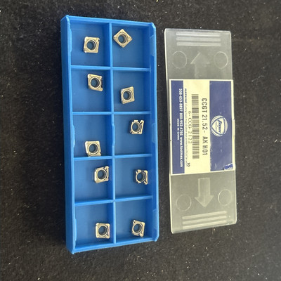

Those that Aaron listed above are specialized and best for small chambers like a PPC.
A 1/4"/6mm indexable carbide shank tool would likely serve you better for larger cartridges. Also shown are polished inserts for aluminum that work great on steel. I think this is more what Aaron was referencing he'd used in the past. @LVLAaron comments?
Exactly. I use both / all of the above. The little micro 100 bar is nice for pre-boring lands on a 5R- But the little 6mm indexable bar is what I usually use for the body of a chamber

Yes. They're sharp as a cats claw and leave a great finish. Less cutting pressure than a carbide bar, which is nice when you've got a tool that's less than a quarter inch in diameter and sticking out 2.5 inches.
And the inserts are dirt cheap.

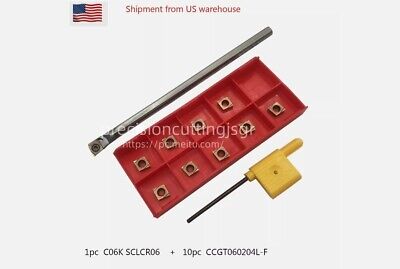

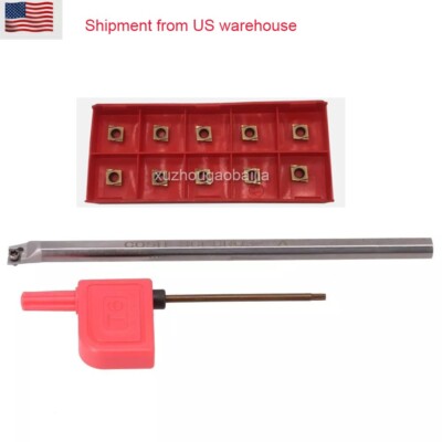

which tool holder for these inserts? Boring bar, profiler, etc.? inserts just confuse the hell out of me to make sure what is compatible with what.
Type in the insert on Ebay and also put boring bar in the search words and you will get the part number, So those are CCGT inserts and you get this part number for the boring bar, Change the search for tool holder and you will get tool holders for turning that use CCGT inserts.
C10K-SCLCR06​
The boring bar will have the insert numbers it uses marked on the shank.
