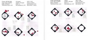

Joe,
Here's a picture from my notes that I took in January 2015. I was experimenting with different neck tension and had not yet cracked that nut. The second picture is after I got the neck tension thing resolved.
