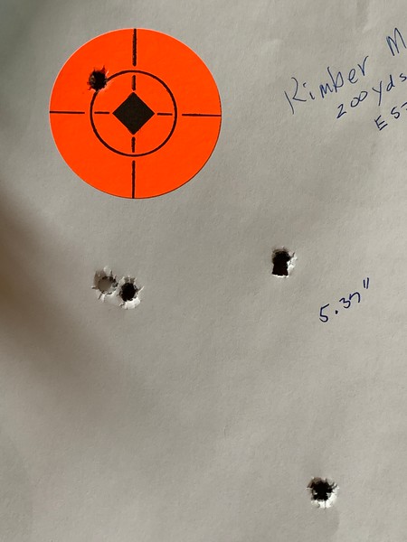

Gun is an all-factory bedded Kimber Montana in .223 Rem shooting Berger FBT 55gn bullets over 26.4gn of AA2230 at 3400fps average velocity. These were shot off a bench with a front rest/bag and a rear bag. 2 foulers were shot from a clean barrel before the groups. 1 minute between shots, 20 minutes between the two groups. Close to zero wind.
I know MOA size can be expected to open up some as the range increase, but 5x from going from 100yds to 200yds is ridiculous.
The ES isn't great, but it isn't enough to blow up a group that much at 200yds . . . ?

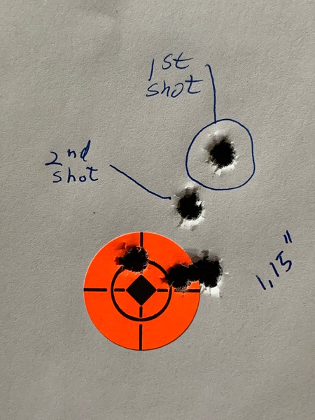

At 100yds, group size is 1.15", ES = 104fps:
At 200yds, group size is 5.37", ES=120fps:

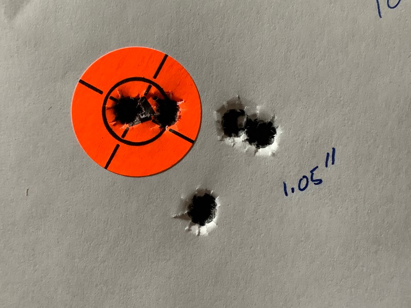

Had almost similar results with a Ruger Hawkeye in .223 Rem at the same shooting session.
At 100yds, group size is 1.05", ES=100fps:

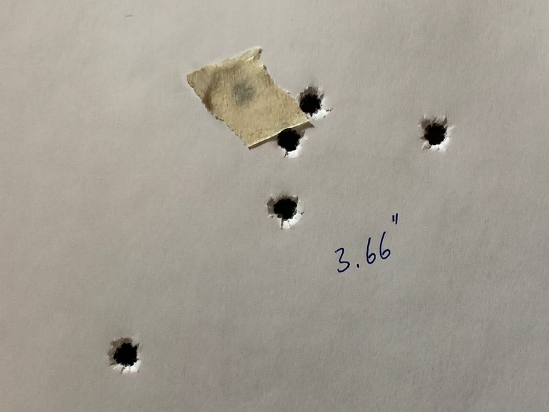

At 200yds, group size is 3.66", ES=144fps:
Curious, the first picture, was that shot from a cleaned barrel? looks like shots 1 and 2 are fouling and tracking in toward your point of aim on the target and 3,4 and 5 have settled in. Also, if 2 different rifles are producing same results, I would consider your set up on the bench at 200 yards. Might be something as simple as your positioning on the bench and on the gun. It seems to be repetitive. This is just one possibility but might be a significant one.

So, that leaves you; I guess you're doing something different. I'll start by pointing to your targets; if that orange dot is anywhere near ideal size at 100, it's way too small at 200. Make sure you can see the targets.
