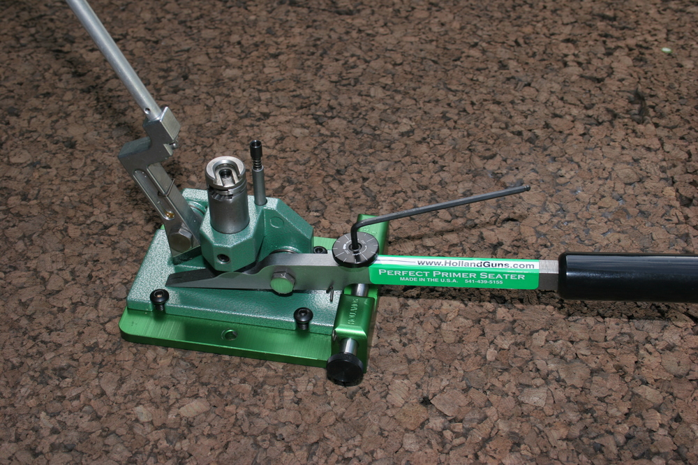

Get the Holland upgrade for the RCBS. It is adjustable and comes with a .0001” dial indicator with an adaptor to measure your primer depth. Way less than half the $$ of the Primal Rights device.
