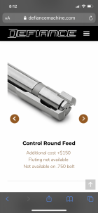

Defiance made at least one cone bolt win 70 crf clone. And it sucked putting a barrel on
Cone bolt with CRF face/claw? How does that work? It does sound like a pain to deal with.
Normally cone bolts are never recommended for repeaters. But I guess with CRF cutout on the bottom of the face it could work
Here it is. You gotta do that stupid cutout on the barrel like a crf mod70 along with a cone
They have been using cone bolts in highly reliable claw CRF repeaters for decades, as in the M-70 and I think the M-54 before it.
My questioning with a cone bolt had more to do with magazine feeding. But I see how a cone would be fine with CRF as it still has a nice flat surface on the CRF bolt face cut to grab the rounds from a magazine.
