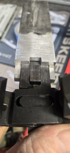

Built the mount but have to trim down the tail end. It will loose a little over half the thickness and about 1/3 of the width. Fits beautiful, will go in a bench/target stock I built with a heavy forend.
bottom
top
underneath part way out
area to be trimmed.
I will finish it tomorrow and inlet the stock. Probably rust blue the mount. I was flying by the seat of my pants on part of this as wasnt sure exactly how much strength and mass it needed but will be extremely strong without being to heavy when done.
