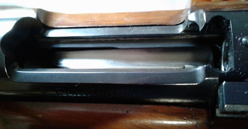

What is this orange stuff?
I see what looks like the same material between the barrel threads and action. Might be epoxy used to make a feed ramp in addition to setting the barrel into the action. Looks like your dad's got his work cut out for him:mad:
Update. We are fairly certain its an epoxy of some sort. Dad removed all the epoxy from inside the receiver, unless is shoots like crap he does not plan on pulling the barrel. He ordered a set of go no go gauges that should be in tomorrow. I have a attached a photo of where we currently sit. If you guys are interested in what he had to do to the bolt I can post those photos as well.

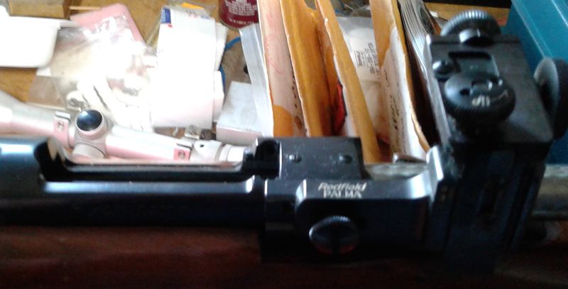

See pics of my 40-XB iron sighted match rifle... it is self explanatory.
The orange stuff is an old epoxy bedding compound called "Micro-Bed" that ooozed up through the front receiver screw hole and got smeared around. It won't hurt anything and it can be picked out. The barrel has not been set back.
