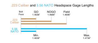

I'd guess the added length in 5.56 is slop for dust/debris and crap to allow for positive operation in a battle rifle, or a bit of extra space for full auto operation. It has (AFAIK) nothing to do with the cartridges being different. Note that length difference only comes up when talking maximum allowed; min chamber lengths are the same for both. To paraphrase, NATO spec *allows" for a longer CBTD (base to datum in the chamber); it doesn't mandate it.
Regarding your inclusion of the pic of the Forster lengths, the article insinuates exactly the opposite: "Conclusion: Headspace gauges for the 223 Remington and the 5.56 Nato are identical."
