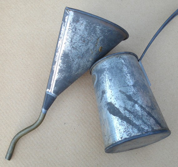

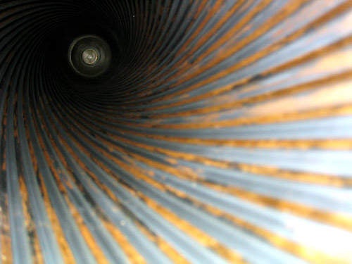

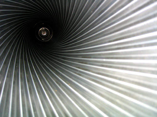

The British would pore 5 to 6 pints of boiling water down the bore to remove the primer salts and carbon from the chamber and bore. If you read Hemingways "The Snows of Kilimanjaro" the same method was used on hunting safaris in Africa.
