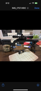

Per your pic, it's going to be real easy for the front of that rear bag to get up against the grip when the gun recoils.

I built the rifle (6xc) with a bergara hmr stock and used cheap sandbags from midway that don’t squeeze at all and the rifle shot very well both close range and at distance 500-600 yds. I don’t like the flat bottom stock so I purchased a krg bravo and a crosstac squeeze bag. But I can’t figure out how to drive it for the life of me. I have been using Harris bipods up front for both stocks. I’m sure nothing I have is ideal.
