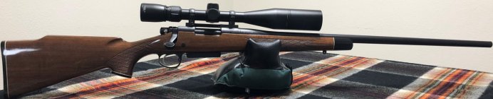

20-222
The 20-222 is no easier than the 20 Prac but having one I'm a bit partial.
I tried to clone 20-222 build after a Rem 700 BDL Custom Deluxe. It doesn't have that rich blueing like they used to have from the factory but even with black cerakote it still turned out pretty good and the little bugger sure does shoot sweet.
