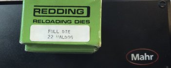

My choice would be the .22 Waldog, hands down. Not easy to make cases, but man does it shoot!

CW,
Mine was a tac driver with VV133 and a 52 Berger FB with 205m primers. Around 3400 fps. When my 6PPC dies I will rebarrel to another 22 Waldog! An amazing little cartridge. Have fun!

Sniper,
Trim .100 from neck length, push shoulder back .100. Problem is now the neck is half neck and half shoulder! Can you say giant step in neck! Very hard to get a perfect neck, to say the least. So, having a lathe, I bored the id, and then turned the od. Would be a real pain without access to a lathe. But, mine outshot anything I have ever owned before or since. I will do another one, when my 6PPC dies.

For 22 Waldog you have the father of the waldog : Dan Dowling: Bet he can answer any questions you have and give you more tips and info than most people have forgotten.
PS. Good news he lives real,real close to you.
