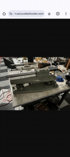

The tube is filled with pourable Devcon. The trick is to get the barrel exactly in the middle of the tube.
Tomorrow, I will make you a pencil sketch as exactly how I did it.
yes, I still shoot my Rail Gun, only with a standard V-Block.View attachment 1612064
Jackie did you give up on your experimental long bedding lug? IIRC that was on your rail.Screenshot_20241209-163818.png
Jackie, per your diagram, you used an already very stout barrel, similar to 1.4 inch straight 6mm I have. Your additional steel tube and devcon contribute their rigidity to the barrel’s, and almost certainly negate its resonance tendency, as it does for the outer tube. Together though, they probably are still lighter than a steel barrel of that outside diameter, and possibly a bit more flexible. I think the main difference though is that I’m planning to put this on a base that supports it as much from the front as from the rear, trying to eliminate any effect of a cantilever design.

Yes I did.
I could not get it to shoot at a competitive level.
I’m not sure why. I thought I had every base covered.
I still have all of the pieces. Additions to my ever growing menagerie of failed ideas.
