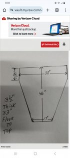

3 1/2” of 3000 psi concrete is more than adequate, easy to form 2 on a sheet of plywood using 2x4s. Just be sure to use enough rebar and/or wire inside the form. NO to rubber.
I have built several for local clubs. I used the "T" design 3-1/2" thick, built forms to have the tops' edges radiused, 1/2" rebar, standard bagged concrete mix. I settled on 33" height based on shooting from various clubs' benches. I wouldn't paint the top and definitely not use rubber to cover them if top accuracy is your goal. I know of no ranges that hold registered benchrest matches that cover concrete tops with anything. The tops are mounted on concrete piers (3) formed by sonotubes which allows for maximum leg room.
