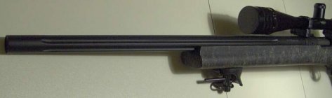

Thanks for all the input. I like the sound of the 6mmBR. Who makes the best barrel for the money? Also, how has a good turn around. I have a few gun smiths in my area.....I will make some calls. Do I need a benchrest stock? Od can I use my HS Precision tactical. What about reloading dies.....Is it worth the money to go with the high end stuff. I have redding and RCBS and a few Hornady.
Mike, if your H.S. stock is the PST 25 model it should be pletty good for what your trying to do. I'm going to throw out another idea for you. H.S. Precision has a rebuild service for Rem 700's using their cut rifled 10x barrels. I had this done last year with my 22-250 and had them put an 8 twist 22-250 on the rifle. This barrel shoots just as good if not better than the previous 3 Shilen barrels I used. I agree that the 6BR is just about perfect for what you want to do and would consider that route. I went with the fast twist 22-250 to try something new and its working out great.
The lead time for the work I had done was 12 weeks and I got my rifle back in exactly 12 weeks. With that said, there at least 10 barrel manufacturers out there that make great barrels so you need to start checking around.
