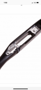

What is a good stock recommendation for vudoo single shot action with a Shilen ratchet 1.2" dia straight bbl. I will be shooting 50 yard benchrest and NRA rimfire f class?
