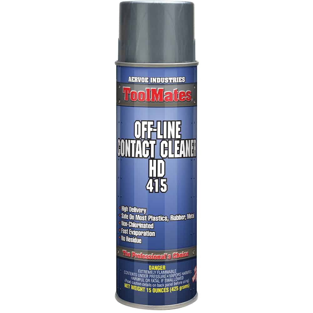

I’ve been using this for 20 years give or take when I need a residue free solvent. My main use started with the need to rinse off electrical motors prior to repair and it branched off from there. I keep a case of it around at all times.
