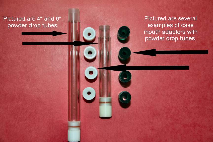

What length drop tube are you gents using? Slow pour?
I use 4" and 6" drop tubes as shown below:
Ron
