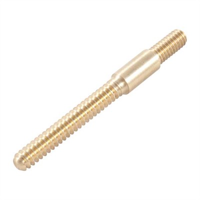

I’m looking at these also, particularly with the use of JB bore compound. My question is, can you pull them back-and-forth inside your bore, in a scrubbing motion, without the felts falling off?
I’m looking at these also, particularly with the use of JB bore compound. My question is, can you pull them back-and-forth inside your boar, in a scrubbing motion, without the felts falling off?
Yes -
The shank on the adapter's are threaded (pictured below), which hold the felts in place very securely.
There are different types of adapters, so the answer would depend on which one you were using. VFG has its own adapter that features a retaining nut that can also be used to tighten the fit of the felt pellet in the bore. Others are made with a combination of a smooth section and a threaded section behind it so that the front pellet will drop off at the muzzle and the one behind it can be drawn back down the bore. https://www.google.com/search?q=VFG...fVnIjcAhUBlawKHWtiBRMQsAQIcg&biw=1232&bih=595

Only ones I have found in the USA are the threaded ones (bought all mine from Brownells).
At least for the calibers I have used them in, I would never need a retaining nut to hold them on.
The felts screw on to the threaded adapters very snugly that have never came off or even slipped.

Same here... except my .30 cal ones are like the one shown above. My .224 one has enough threads for one, one-and-a-half felt(s), and the remainder are on the unthreaded portion. Not especially handy when you are trying to scrub back-n-forth with JB on them; the front ones keep coming off.
