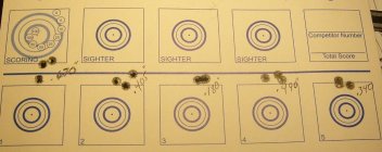

Stock problems. !!!!
This target shot yesterday testing a new bullet with just 2/10ths grain of
N-135 between each 3 shot group. Upping the charge took the vertical
out and replaced it with horizontal. Now I will play with seating depth to
reduce the horizontal.

OP states it started ok after group testing, then got worse, also states nearly 300 rounds on the barrel. I bet an anti-node was picked and now the barrel has sped up, pushing him to a between the nodes situation.
Shoot a powder charge test with 3 round groups with ~1% steps in charge weight at a horizontal string of aim points at 100y. Look for the groups that print highest above poa. That will be close to your stable load. You can always fine tune between the steps if you like later, but the target should look like this.
