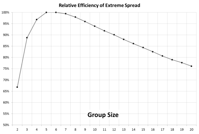

Discussion often revolves around how many data points is necessary to obtain a meaningful answer, and this is a major point so as not to be misled making false conclusions. There is not a fixed answer for this, but following Donovan's example I will put together an excel file to share where you can enter your sets of chrono data and it will tell you if there is a statistical difference in variability (or not).

True, but you reach the point of diminishing return where more tests is a waste of money. I learned to live this in industry 45 years ago.

Sure wish barrel heat, fouling, wear, and ambient variance wouldn't effect the data out comes of our test sessions, like they do.
Then add in the expense to components and the time and expense to prepare creditable ammo and to conduct tests, further hinders how many liable rounds should be fired for sample size.
Do to the above mentioned hindrances, expenses, and labor, it is always my goal to efficiently use the least number of shots as possible to group size and ladder size. That has always been a reason why I base most my discovery on ES, since typically I'm using relatively small samples for statistical aspects. With vertical dispersion spreads (ES) on the targets, at target distance, being the most important data point I myself look at and judge by. Below is a "Relative Efficiency of Extreme Spread" by group size, ballistipedia chart.
Donovan I had skimmed that article some time back regarding group sizes. In the case of comparing chrono data for the purpose of determining whether an improvement has been made, the statistics are very straightforward based on standard deviations; this is a much more robust statistic than ES. Of course ES is the measure of group size for many competitions, but on the other hand scoring as in F class is pretty much a graphical representation of the SD. I will email you the chrono calc program when I finish to get your input regarding what else to add before posting.
