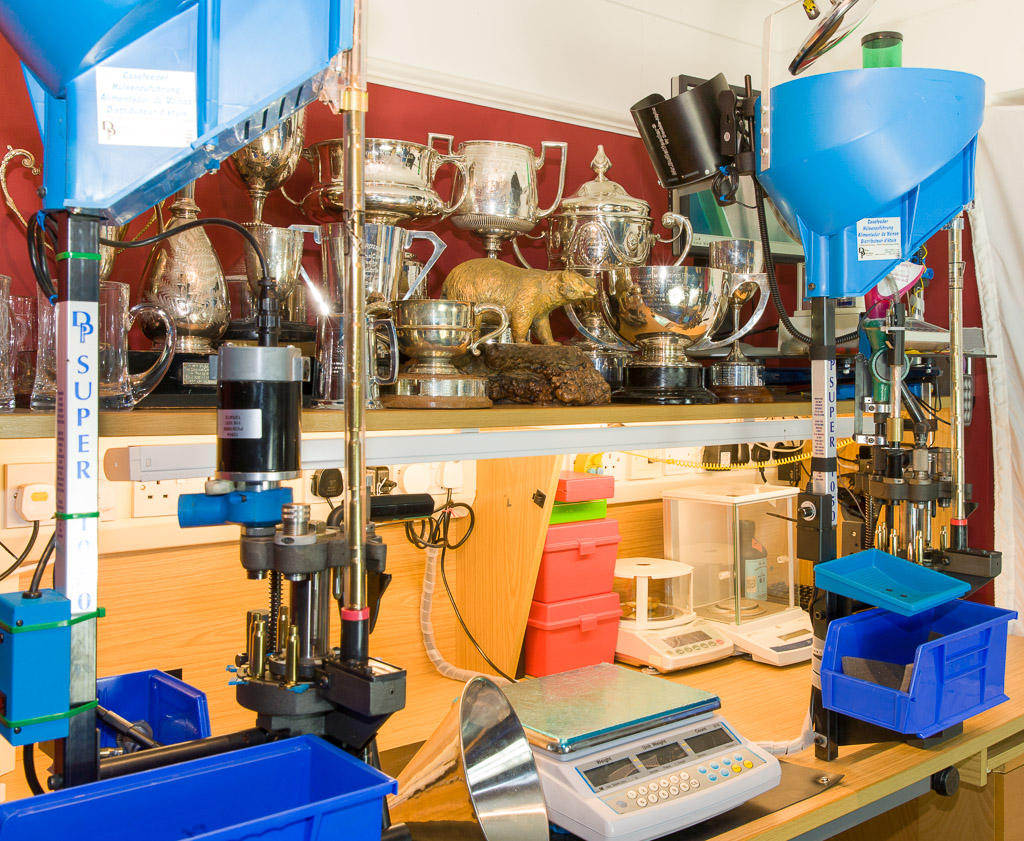

I use a pair of 1050s to load for Palma shooting up to International level.
Seems to work pretty well.
Dimensions (trim, shoulder position) typically sit within a 0.001" spread over 500 cases. Not a great deal of room to improve that, and arguable how much benefit there would be.
What's your setup like on those? I'm not as familiar with the 1050 layout / operation...
Looks like an RT1200/1500 on the left one to size & trim, and a Sinclair expander mandrel to expand the neck? One on the right looks like an RCBS Uniflow w/ case-activated powder drop, bullet feeder, and Redding Competition seater?
Hard to believe you're using thrown charges with all those lab scales laying around... o_O
How many people are you loading for? Seems like you'd be able to load a season's worth of Palma ammo in a few hours!
Pretty close! Mandrel is a PMA Tool 0.307" carbide in a Sinclair die. I've actually moved that to the loading press (Goliath) since taking this photo.
Pass 1 on 'Samson' (Left press, case-prep):
  • 2: Decap
  • 3: 0.310" Expander*
  • 7: Redding Small Base Body Die
Pass 2 on 'Samson' (Left press, case-prep):
  • 2: Decap
  • 7: CH4D Dillon Trim Die + RT1200 (FL Size & Trim, matched to brass neck thickness)
Pass 3 on 'Goliath' (Right Press, loading):
  • 2: Decap
  • 3: 0.307" carbide expander floating in Sinclair expander die
  • 4: <prime>
  • 5: Custom flare expander floating in Sinclair expander die**
  • 6: Powder Drop
  • 7: Bullet Drop
  • 8: Redding Comp seater
* The .310 expander serves 2 purposes: open-up any dinged necks, and the die body contacts the shell-plate to counter any tipping force from the sizing die in the opposite station.
** This is a bit like an 'M' die, but floats in a Sinclair expander die, and the smaller diameter doesn't do any expanding. It just puts the tiniest bit of flare on the case, which is the progressive loader's alternative to chamfering.
Actually, I don't throw charges *that* much - the setup you see here is for dropping weighed charges (see video below); in this configuration it *only* loads about 300 rounds per hour at a tolerance of about +0.02 grains, but I'm increasingly using thrown charges for short range (600 yards or less) and/or for higher quantities.
It's still quite time-consuming, and I shoot about 5,000 per year and load an additional 7,000. If I'm stainless tumbling there's actually a fourth pass (before the 3 above) to decap before tumbling. Pass 1 and 2 could be combined, but there would be a reduction in the consistency of trim length and shoulder placement. All the processes on the left press can run at close to 1000 cases per hour, while loading runs at about 300 for weighed charges or around 650 for thrown. I'm working on improvements to the dispenser that should increase the throughput to around 400 per hour, and a method to automate the powder transfer that I hope will hit 500 per hour. In all cases the charge tolerance can be opened-up to increase the throughput; I run some loads at a 0.06 charge spread instead of 0.02.
Here is the weighed charge process at its slowest setting (+0.02 tolerance), dispensing 46.00 to 46.02 grains in about 6 seconds, making for a cyclic rate of 12 to 13 seconds per finished round (starting from fully prepped brass).

I just recently started messing around with on-press trimming (for .223 Rem 'bulk' ammo)... I went with a decapping die, a Honey Badger trim setup (Bosch 1617EVS router w/ 3/8" endmill mated to a Dillon size/trim die), and a Lyman 'M' die. Still early days (for me), it's gonna be take a while before I trust that setup as far as I do my Giraud or Wilson trimmers. Mine is definitely a bit cramped all jammed together on a 4-hole press!
Not having to fumble around placing cases and bullets is nice, though, and having the powder thrower drop the weighed charge in the case when it's ready and in position is slick. At first I was thinking 'why?'... until I thought about the times I've had someone/thing distract me, and ended up dumping powder down the funnel with the ram/shellplate *down* :mad:
The charge/seat portion... honestly doesn't look much, if any, faster than what I get with my 550 + AutoThrower + AutoTrickler. I've never timed or videoed myself doing it though, so I might be all wet on that.
Then again, for me a large part of the 'goal' wasn't necessarily sheer production speed, so much as it was to reduce the number of 'touches' (to quote @Jay Christopherson) i.e. how many times I have to touch each and every dang component. I'm well and truly over the obsession of having to finger every round umpteen times from start to finish, at least at the volumes involved for traveling to multiple larger tournaments.

Thanks! It's been many many years of research, development and refinement. Hopefully many more to come!
Yep. I think I did that twice before deciding I needed to come-up with a better way. But the more important aspect is that interrupting the cycling of the press (to drop the powder mid-cycle) does not lead to consistent press operation, and cycling the press in a consistent manner is especially important when several things are happening at once.

I started with an M die. They have a bit of a reputation for inducing a little bit of runout, hence I switched to the Sinclair and some custom mandrels.
I think the main thing for progressive precision is to separate any 'forceful' operations that could have an effect on other operations - that's mainly anything involving the shoulder. If you're setting the shoulder at the same time as trimming, for example, you'll see a little more variation in trim length. In my 2-step case-prep process, the shoulder is basically set in pass 1, so pass 2 is usually just sizing the neck while trimming (although it gives a second attempt at nudging the shoulder on a case that was a little stiffer than the rest).
Also, keep an eye on your shell-plate to see that there is no correlation between any variation and a particular station. I've replaced a shell-plate or two after attempts to free a stuck case left one station maybe 0.001" or so different from the rest.
