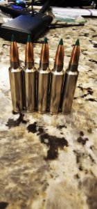

69 gr Sierra TMK
27.5 Gr 2000 MR
Fed 205 M primer .....I forgot to use the CCI
2.709" OAL is .020" off lands
matched the brass all federal
