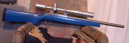

Well I started this build last May. I obtained a pretty beat up old McMilan Graphite stock, as well as very neglected Panda action. With a .378" bolt face, I really thought about selling it. But being Fred Sinclair used this cartridge a lot to shoot his way into the BR Hall of Fame, and was quite fond of it, I decided to try one for myself.
I had to settle for a rented reemer I knew nothing about, a Shilen Selec Match barrel, again not my first choice, but a known performer. But since this was the first 222 Rem. I've ever owned, using second choice components and tooling, I opted to try another first, rachet rifleing.
It has been a good shooter, winning several group and score matches out to 200 yards, even a 1st in a 200 yard egg shoot, that was shot using paint balls for the targets as well as eggs.
I ordered a custom reemer after getting some Lapua Brass, and a Wilson FL Bushing die, and used them with 52 grain Match bullets to design my specs around.
Well in May I believe we built this rifle using top end components at a basement cost. It turned out to be the most fun build I've built in the past 30 years since my first 6ppc.
So after waiting since early June on the reamer, I obtained an early Krieger LV 1-14 twist barrel, to cut when the reemer was done. I got it late October, or early Nov. but with our match season over, I was in no hurry to cut it.
Well yesterday we cut the Krieger, after shooting the Shilen with a turned down barrel to get a 21.5" barrel to 10# 1.5 Oz. for the past 9 months. So it would make 10.5# if I wanted to use a modern 30mm BR scope, instead of the old School B&L 36 power, (thanks Al, it's been great) after this past summer I decided using the old classic 1" tube scope was part of the fun and nostalgia competing with the newest and baddest 6 ppc, and taking down many each match.
So with luck a calibrated length of 21.5" with the LV contour was decided to be close, and if not cut it back from there to dial in the the 10.5# max wieght to use it in both HV & LV class as well as Sporter if I chose.
We nailed it,, 10.52# not sure but I think 2/100 of a pound, is accepted in the + or - leeway for wieght? If not, going to single screw scope ring on the rear will make it legal. So i said perfect,,, crown it! Same exact length, and with 6.5 more oz. than the Shilen. Should help with its manners on the bags? But I'll be able to see if I can get the same velocities with the loads I did in the Shilen, which seemed 100 to 150 faster than expected with every powder combination I tried. Not scientific, but both same length, both 4 groove, Shilen rachet rifled, with .219" bore, the Krieger is straight cut rifled, with a .218" bore. 1000001301.jpg
So with 200 rounds of new 222 Lapua MATCH brass cut for a .2443" loaded neck, and prepped for the .246" NK chamber, all within .1th of a grain, and another 300+ within .4th of a grain. And 2000 very special custom BR bullets ready, along with Barts and Bibs 52 grain, I should be set as long as I don't run out powder and primers. And I'm really hoping to cut .1" off my aggs with this new barrel and chamber. No matter what, I'm going to be one happy old man for some time to come!
Fred putting the official crest on the barrel, making it official,,,,, ready for pleasure!
With this winter weather finally arriving I won't get much load development in, but I've shot two rounds today, cleaned after each, very minimal signs of copper on the first round. The second none, but cleaned and JB'd the second time just Fer good measure. But will shoot 2 tomorrow, in 40 to 50 mph gusts, just to see. Then, wait till mother nature tells me I can play again! He'll, I might never shoot my Bat in 6 ppc again?

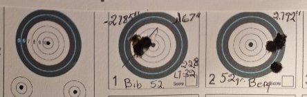

DAY 2 - Today with 48* and sunsine I set out to fire some more of these new cases. 10-15 mph winds with gusts to 20. But hey, the sun's shining and I can't wait no longer to get some more brass ready for load testing.
One thing I didn't do on the initial fireforming was neck sizing after I had turned the necks. So I ran them back thru the .241" bushing. These cases were all bought with a ??? Primer in them ??? No idea what primer or how long before I purchased them they were primed. All I did was bottom them out in the Wilson bushing die, and expand the necks with my K&M turner mandrel, and turn to a loaded .2443" dia. Then neck size with a .241" bushing this
With the 133 showing little promise, I loaded LT-32 in the properly neck sized brass wit a berger and seen no gain. But did load 5 with LT-32 and a 52 grain Bib bullet. In fairness the Berger was loaded into the lands, and this is the only cartridge i have that likes .006 to .003 of jump, even .010" off is better than touch..2.292" is touch.
The left five shot group was with the Bib 52 grain, with a load that shot good in the Shilen barrel, the right was the 22.5 grain N133 load with a 52 grain Berger at touch. Not much better than the looser neck results with 133 at touch.

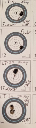

But I did load some of the 47 grain bullets I aquiered using a .241" neck sized, same new brass with the mystery primers, and LT-32 powder like in the 5 shot group on day one with the Shilen barrel ammo.
This time I tamed the 25.0 grain load shot in the Shilen prepared cases down in these new cases. The Shilen shot decent, as did this barrel, and the Shilen turned in 3645 fps. I started these loads, just three of each, with 23.7, 24.0, and 24.4 grains of the same LT-32. All with 3 each at 2.785", 2.788", and 2.792" col. according to my Sinclair comparator.
I did slowly adjust the poa to center it and left it alone after the 24.4 grain load. Final adjustment and zeroing the turrets will be when conditions are optimum. But we're good to go hear with either bullet.
This was great, and the 47's are where my efforts will begin. I forgot my sky screans, and the first 3 shots @ 23.7 grains were not recorded, reading errr2, but the .056" 3 shot group was, a surprise in the conditions I was shooting in.
But while cleaning and after a few shots at steel @ 200 yads, the clouds came back. Now the chrony was ready to go and would read the 24.0 grain load and it was recorded, as well as again shooting all 3 shots into an under .1" group measuring .082" @ 3469fps. Target #17
While it was not any better than the .056" group at 23.7 grains, it was better than I had hoped for for both groups, and no slouch at 3469 fps average, and only an 11 fps extreme spread.
Now with about 15 rounds since cleaning, I wanted to clean. But with one more load of 24.4 grains waiting, with these little 47 grain bullets, I just couldn't wait, I had to see what they would do. Again a little bigger, but this early with the new barrel, I was happy. Target #22 was again one hole, growing @ .218",
But in these conditions shooting in an open corn field, in the Great Black Swamp of Ohio, it very well could me! But now we had 3542 fps average, and a ES of 8 fps. Or a 3 shot, 3 group ag of .119" with these bullets, using three different loads, and two different seating depths!
Not ideal conditions or the most solid bench setup, but good enough to give me a starting point with my batch of once fired brass now, and the 47 grain bullets, with LT-32 powder will be it.
We now have hope, and I only have one direction to go. I just need some better weather with good testing conditions. I think Fred was smiling down on me today!

3542 fps on target #27, 24.4 grains, and the 25 grain group with 47 grn hp shot 3645 fps, under 1/4" 5 shot group. And that is with a confirmed chronograph. Checked with a Ohler 33, and a magnetospeed. All printing within 12 fps of each other. As well as these speeds duplicated with the same 22.5" Shilen barrel. It used their rachet rifeling and I see no significant diferance in speed.
If I were using this for varmint, the 25.0 grain load would be it, and that one was a 5 shot group on day one. But I will gladly trade 200 fps for this guns purpose, and that is accuracy priority one.
Those three loads all are possible, with only one shot out, on one of the groups, out of all three loads, on the bench I was on, in the gusty switch winds in a wide open corn field, was no serious testing conditions. As well as only three shot groups, but this next week, with 50's and 60,s forecast. I will get some solid range time in on the perfect range in Hilsdale Michigan. We have an incredibly protected 300 yard range.
We have graduated with this load work to 5 shot groups now, with .009" seating depth test, in .003" increments, in and out, and 1 grain charge range, from 23.5 to 24.5 grain. So next week I hope to have a final load proven with multiple 5 shot groups, and will report here.
