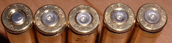

1) I have overload worked up 223 many times.
2) I have overload worked up 9x19mm many times with 0.180" feed ramp intrusion with a 0.160" thick case web and a 0.015" thick case wall. That is good enough case support for overloading until the primer falls out.
3) But I have never overloaded a 223 with feed ramp intrusion.
4) My guess is that if Doug has 0.009" of unsupported case wall 0.040" thick, the primer pocket enlarging will still be the weakest spot in the brass
