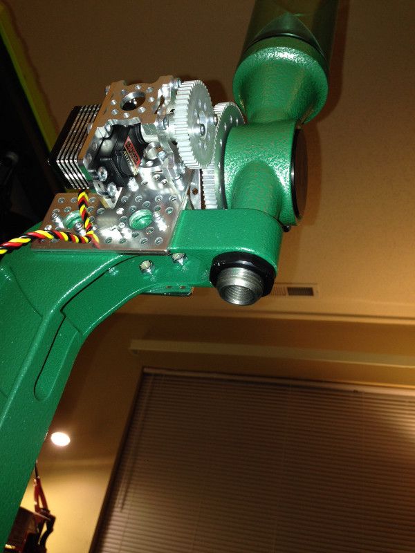

Not dropping too much while being quick is the main challenge of tweaking the numbers. Because the stepper provides truly continuous speed control, is capable of running VERY slowly, and the scale provides the weight 20 times a second, the trickling speed is a function of weight that can be tweaked. If I set it just a little too low, it will almost never overthrow, but sometimes might take a few extra seconds to finish. I will be providing a slide setting in the back which can be used to set the 'aggressiveness' of the function so that you can tune it for different kinds of powders. For any powder, there will be an 'ideal' setting that minimizes time while making overthrows very rare. I will make sure it works well for fine ball powders like H335 and larger chunks like N150.

the omega has 2 batteries. when it runs on both batteries it runs fast. when it runs on one it runs slow. controlling the voltage is what makes it run fast or slow. if you can program your arduino to supply more or less voltage to the omega depending on the weight you got it made.
Using PWM control does pretty much the same thing. Using the Omega, if you use 2 batteries the speed will be "fast" at 100% duty cycle. If you drop it to 50% it would be at the one battery speed. However, you can control the duty cycle from 0% (or at least very close) to 100%. The resolution depends on the number of bits the PWM controller uses. I believe 8 bits would give you about .39% resolution.
The problem with DC motors is they require some minimum voltage to turn at all, below which they just make noise. The speed is also non-linear with voltage. Setting voltage is usually done with an encoder for measuring the speed and feedback loop. With a stepper, you specify a very specific rate (number of steps per second) so it can run very slowly, and know for sure that it is turning.

I automated the FX scale with the omega trickler because I had one...however a stepper motor is superior due to its ability to provide continuous speed control down to zero. The setup uses PWM to control the omega, but I found that when you get very near the target small pulses provide better control when using the omega.
Here is a video I took this morning showing the omega integrated with the scale.

To those wondering about building your own... you actually need TWO arduino's, which I discovered was the solution to the serial port interrupts interfering with the delicate timing for proper stepper motor control. But I can't give away all the secrets now can I :)
I've been getting a lot of questions about converting an Omega trickler. The stepper provides great speed control, but is there some other advantage with the Omega that I can incorporate into my design? Perhaps a larger hopper? Would appreciate any feedback you can give because I don't have an Omega.
Regarding having it work with other scales, it is possible but I don't have an array of expensive scales so it will take some time. I could use some help with this. Specifically Sartorius and Ohaus.
