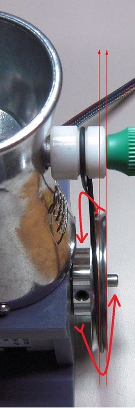

I just realized this picture from the instructions is wrong. The green handle should be pressed up like in the above posts. That's what you get for getting your fiance to take pictures for you :)
You are right it won't quite line up and I think that's fine. I still have to print the white pulleys for the next batch so maybe I will make them a little longer to bring the belt out a bit. Might help prevent slipping.

What would happen if you flipped the big pulley on the stepper motor shaft, and then rotated the trickler a bit so the "belt" doesn't rub against itself?

Yes, I think if I can pull the large pulley out and put it in reverse, that might do the trick. Not sure you would need to add washers as the pulley is locked on to the spindle with a Allen screw. When I loosen the Allen screw it did move in and out a bit but did not seem to want to come completely off - Adam should comment on this.
It will come right off. Feel free to experiment. My intention was to get them roughly lined up.
It works. The pulley assembly came off with a few back and forth pulls and I installed it backwards. You can see in the photo that I am pretty close, maybe come out a slight bit more and it will be perfect. :D

The pulley and the drive on the hopper spindle do not line up when you get the drive over the pin. It's about 3/16" out of alignment. Clearer pictures? Great Idea, maybe I'm doing something wrong.
I turned the pulley around on the motor shaft and all lined up. Overall, this is probably better as it has the tension closer to the powder trickler, less leverage to cause wear. Every little bit helps.

I will consider installing the hub/pulley the other way around. It's a simple mod and seems better.
Adam, I tried the twist/no twist today and have to agree with you i.e. the twist works much better. Seems the no twist runs smoother (at least if judge by the sound it makes) but the throws are not consistent/accurate - must be slipping as per your comment. Turning the hub/pulley the other way around does not appear to have any negative effect.
