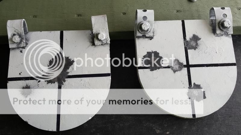

3/8 AR500. It has been hit a few times at 100 yards, but most hits are 500 to 1000 yards. Repainting is all that is necessary. Occasionally the steel hanger straps need replacing.
