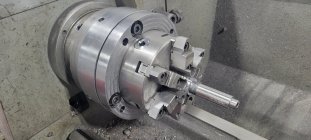

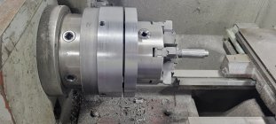

True Bore Alignment System
That's a great and fair question. I do want to preface my answer by acknowledging that I have been changing a lot of processes around dialing in, and change often leads to increased time--especially at the front end. I started with tapered range rods and transitioned to a much more repeatable "Grizzly rod." This evolved into using the "Grizzly rod" to get close enough to drill, bore and direct indicate.
My strategy moving forward with the TBAS involves a similar methodology: to achieve preliminary alignment using the TBAS & SSG rod, followed by drilling, boring, and the direct indicating processes to attain final concentricity before proceeding with turning, threading, and reaming.
With that backdrop I am estimating approximately 2 hours +/- 30 minutes of setup and dial-in time before making the first chips prior to using the TBAS.
I do think a meaningful amount of time can be saved now that I can eliminate the shims, the back and forth between the front and rear spiders and the constant verification that nothing moved between dial-in to threading to reaming.
Hopefully that is a reasonable answer.
Hank
How do you find the SSG rods compare to the Grizzly rods? And how close did they get you when you directly checked the lands/grooves?
In my experience, if you go to the true bore alignment website and read the process as documented for truing the bore with their range rod, I would say that the true bore alignment system rod is [much] faster than the grizzly rod. For reference, I am not a professional and cut less than 20 chambers per year.
Hank

As a Machinist, I think this system is a good example of a asinine solution to a common problem, that being how to true a barrel for chambering. In particular, in a lathe with a long headstock.
True, it is innovative. But telling people…..”this is great, except due to the excessive overhang and out of balance condition, you might have to spend $20,000 on a lathe upgrade”.
There are many more options in barrel set up that are simple, far less
expensive, and works on the machines that multitudes of Gunsmiths already have.
Jackie brings up a point that you never see talked about. Balance. There was an issue with a very good action got traced back to that problem. When you dial in a part, its not spinning. When you turn the lathe on, if the chuck or part is out of balance things will flex due to centfifical force and your part is no longer dialed in while spinning. Yes this is a real problem. One of the reasons that I have not gone cnc or bought this style of chuck. Theres other reasons but balance is the main one.
