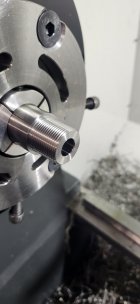

I do barrels on a Haas TL1. Custom front "spider" and rear spider. The TL has a shorter length head stock, which is one of the reasons I bought it. Dialing in a barrel is no different than on a manual.
